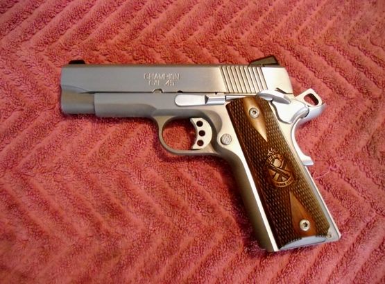

Picked up a project this weekend. SS Loaded Champion. It's a 2006 version, but it was somewhat neglected. I'll post some "after" photos in the next couple of weeks. This is what it looks like today:

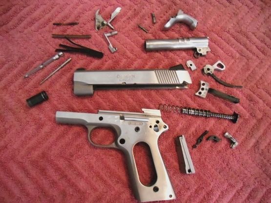

...after a week of working on it in my spare time. Leftover stocks from one of my other Springers:

Looks incredible! How did you refinish the frame and slide?

I taped off the flats and used low pressure and plastic media in my small blasting cabinet for the rounded areas and trigger guard. I used my small sanding blocks for the flats - 240 grit working my way up to 600 grit. That took awhile since those idiot scratches were almost gouges. :(
